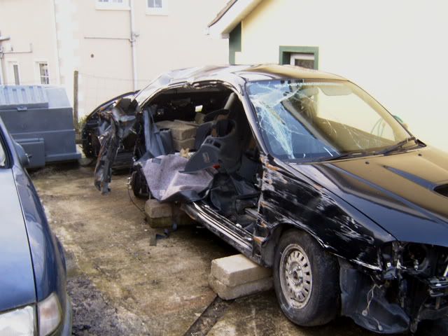

then bought a smashed glanza in march of 2006 and started the conversion in may,had it finished by august....
lasted a month til i blew the engine due to boost creep and no fueling mods.

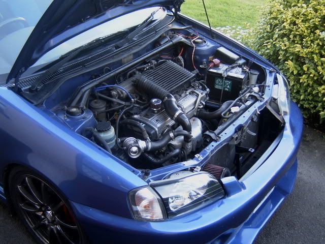

ENGINE AND PERFORMANCE:
apexi filter
custom cat back exhaust in a hks super drager
wepr fmic
blitz boost controller
greddy turbo timer
greddy emanage ultimate
blitz bov
trd engine mounts
air filter relocation pipe
tdo4 turbo
wepr tdo4 m/s external mani
wepr screamer pipe
wepr downpipe
turbonetics external wastegate
factory lsd gearbox
roadrunner paddle clutch

engine bay pics..
