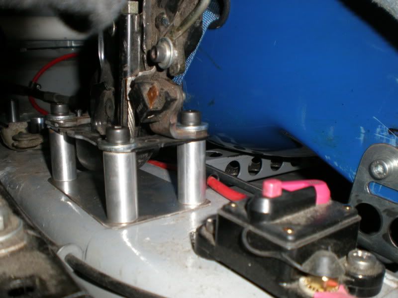

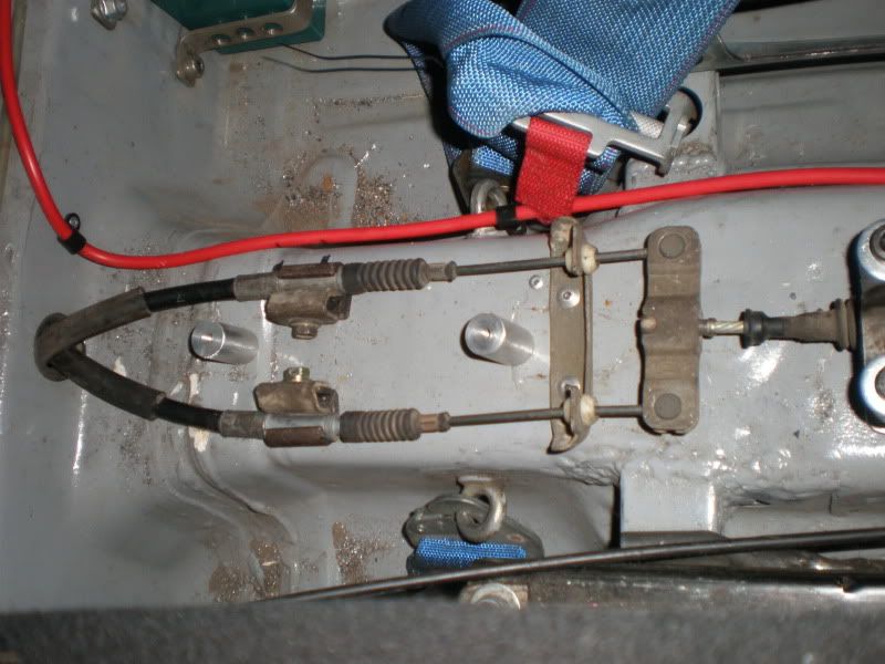

Seeing as there's no racing for a while I decided to do some mods to the car , the exhaust has bugged me since I made it that it hangs down below the floor , but the handbrake cables etc were in the way. The pic shows how much it hangs below the floor , and yes I realize it's not that much
but it rubs on the ground when I autocross in paddocks and makes the muffler hit.
1st up I made some 40mm spacers to lift the lever up , and a stainless plate to cover the hole.
Then I removed all the brackets from in the tunnel and remounted them inside the car. I hole-sawed a new hole for the cables to run , and you can see the spacers I made to lift the fire extinguisher to clear the cables

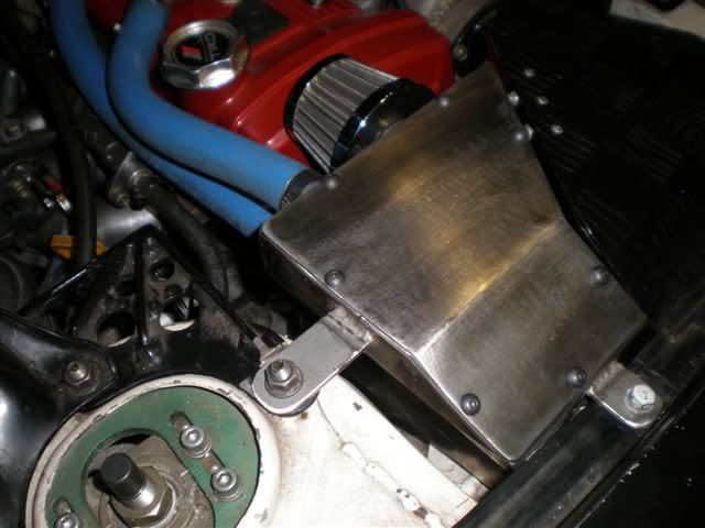

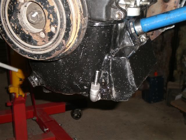

I have just about finished my oil/ air separator . i have upgraded the hoses to 19mm inside diameter so there should be plenty of breathing capacity . here's some pic's

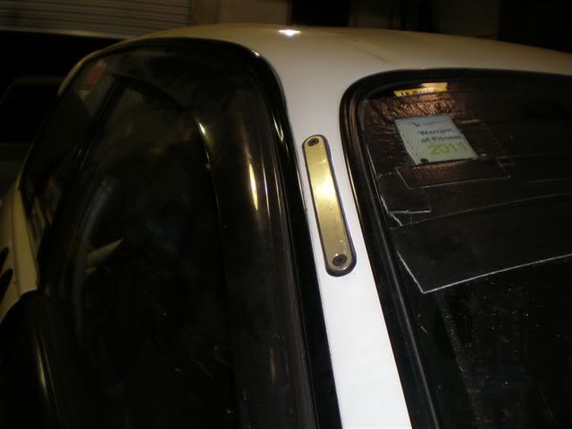

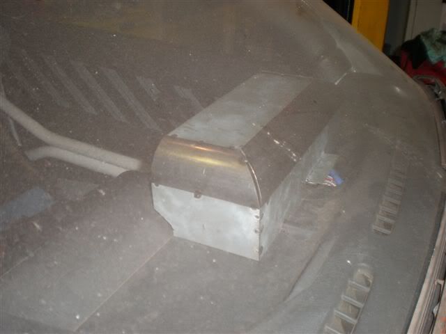

And here's a slim line cover I made for the Ariel hole , can you tell there's no racing on at the moment ?

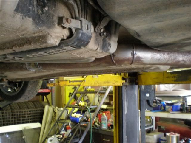

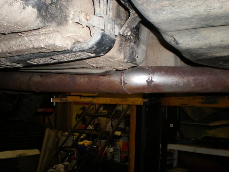

here's the finished exhaust position
and here's the original setup again , not much difference I know but after a vigorous test drive it doesn't hit anywhere and it certainly won't hit the ground like it did

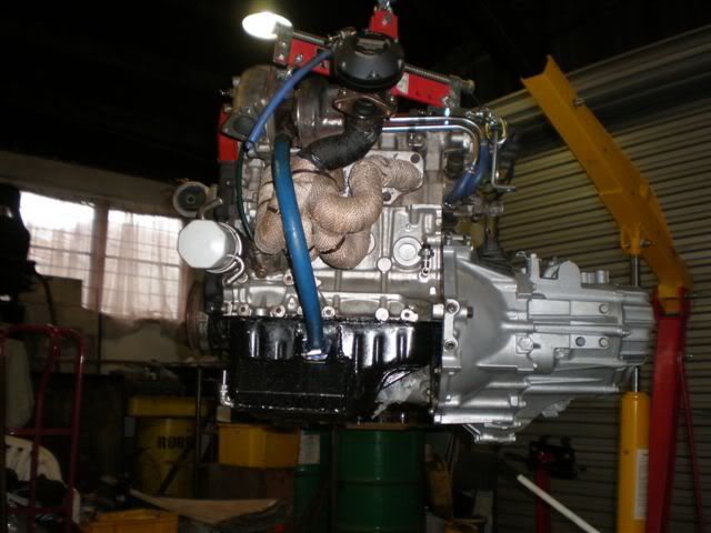

I am in the process of pulling the motor and box to do some work on them . I am overhauling the LSD as it is getting weak , not that surprising as it's done 70K since I've owned it inc lots of racing and it was secondhand when I got it
I got a TRD rebuild kit off Toyota ( thanks Mark) , and I want to be able to test the breakaway torque , both what it has now and after I rebuild it , so I made these out of some old inner C.V's I had .
If anyone knows what sort of torque range it should be , please let me know.

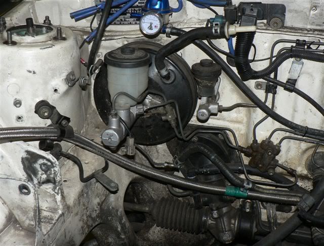

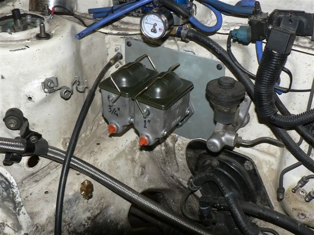

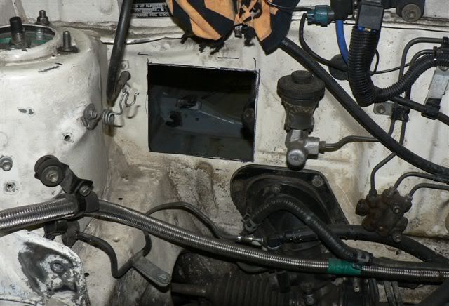

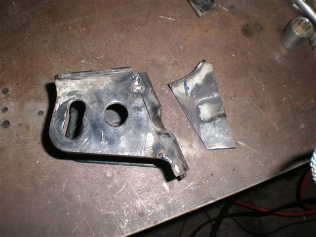

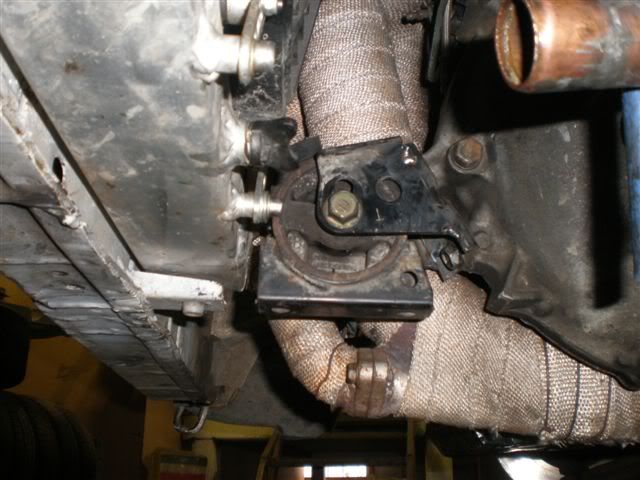

Before I pull the motor I though I'd look at adding a 4th engine mount like the corollas have , I found one off a AE101 at pickapart so started trial fitting it today.
Here's a pic of how much I had to cut out to get it to fit in the space. You can see where I tacked it back together after removing the bit to the right.

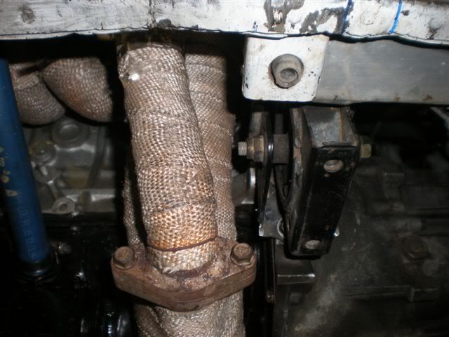

and here's how much clearance it has to the radiator
and to the dump pipe
So as you can see, enough but only just
the fun part will be making the bracket to attach it to the crossmember , theres going to be some thinking involved , and on a weekend too

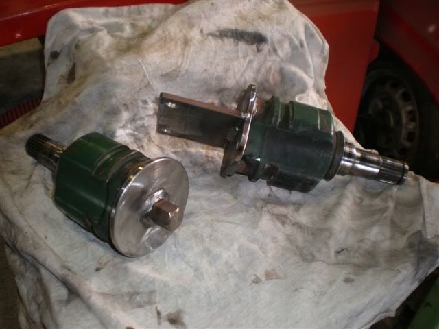

I have rebuilt the LSD , old breakaway torque was 33 Ft-Lb , after is 54 Ft-Lb . the plates and spring washers were showing a small amount of wear .

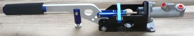

I ordered some wilwood calipers for the back seeing as the exchange rate is so good , the 2 calipers and wilwood pads inc freight cost NZ$340 ish ,
the plan at this stage is to fit them as a separate handbrake system and in the future use them to replace the factory calipers

I have finished doing the LSD rebuild and reassembled the box , painted it , then finished the sump mods , if you look at the sump in the exhaust cutout area you can see the drain channel I put in . In the next pic you can see the oil drain I put in for the oil/ air separator.

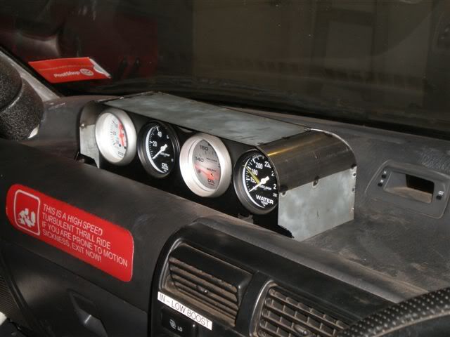

I have also been making a cover for the gauges on the dash , mainly to stop reflections , especially at night with the lights on , as you can see , it needs a lot of work , but the basics are there.

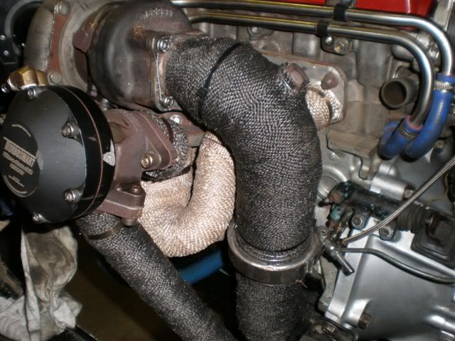

I spent the weekend fitting the v-bands to the exhaust and it's finally done , just 3 nuts to get most of the exhaust off
while it was off I weighed the exhaust and from the turbo back it came in at 19.2kg which i thought wasn't too bad for a 3" pipe

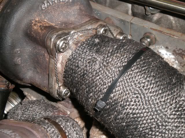

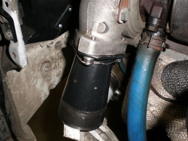

I also decided to lock wire the compressor exit adapter on as it had come loose , and the dump pipe to turbo ,
drilling 1.5mm holes though stainless cap-screw heads sucks real bad , i ended up paying a toolmaker friend to do it .
obviouslly I need to replace the cableties as I suspect they won't handle the heat
I should have the front of the car fully back together this weekend , then i can start re-organizing the inside ,

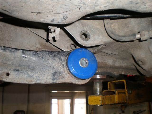

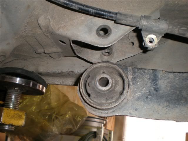

I decided a few weeks ago to change the mounting bushes in my rear beam axle from
to

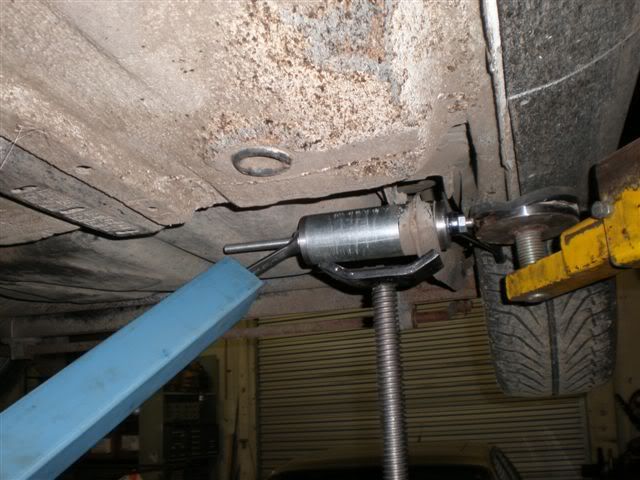

I decided that I would try to do it on the car as it looked like way too much work to pull the beam out of the car

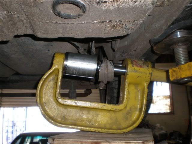

I made up a manual puller that basically used a M12 rod to pull the bush out , it looked like this , note the long RHS on the spanner
and it was a failure , the threaded rod started stretching before the bush started moving , so it was on to plan No 2.

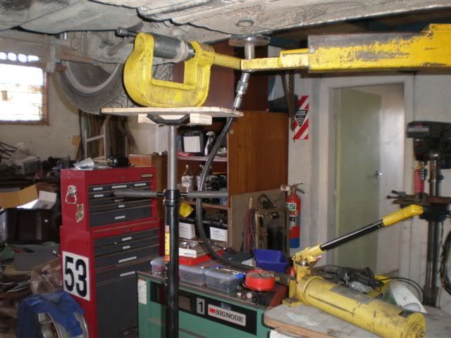

I hunted around work this morning and found this set up
This was more like it although after doing the 1st one I decided that earmuffs were needed for the 2nd one due to the loud bang as the bush came out
So the back end should be better controlled now as I could deflect the rubber bushes with a lite pull on a screwdriver , and can't do it with the new bushes ,
so I now have WRX parts in my car
but they were a straight fit
to

I have ordered a dual master cylinder brake pedal , 2 cylinders and a remote adjustment knob for the xmas brake upgrade project , I hope to have everything ready and all parts etc by mid december .

I have started the brake upgrade on the starlet.
1st up was removing the dash which took all afternoon on the 1st day, the wiring will definitely be getting a sort out before it goes back in
Next up was to remove the motor/box so I'd have room to work, I finished that day by removing the old brake pedal.
Today I started with this
Then I did this ( after quite a bit of thinking , theres no going back , not easily anyway )
By the end of the day I had the new master cylinders mounted along with the new pedal including a brace bracket for the pedal
I will get more pic's as I go along
