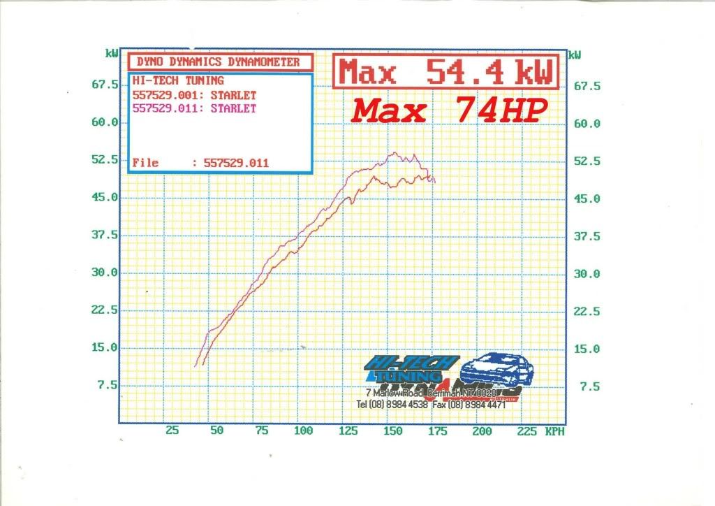

1st mods were wheels tyres /2in s/s exhaust + extractors/ ECU microtech plug& play swap/ kings springs/KYB shockies see tune see below

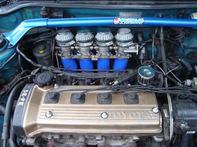

then i aquired the ITB`S
Image (prev owner photo)

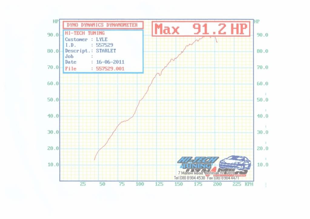

fitted P&P head /thin h/gasket /H/D valve springs/set c/shafts / ITB`S/ polished T/cover

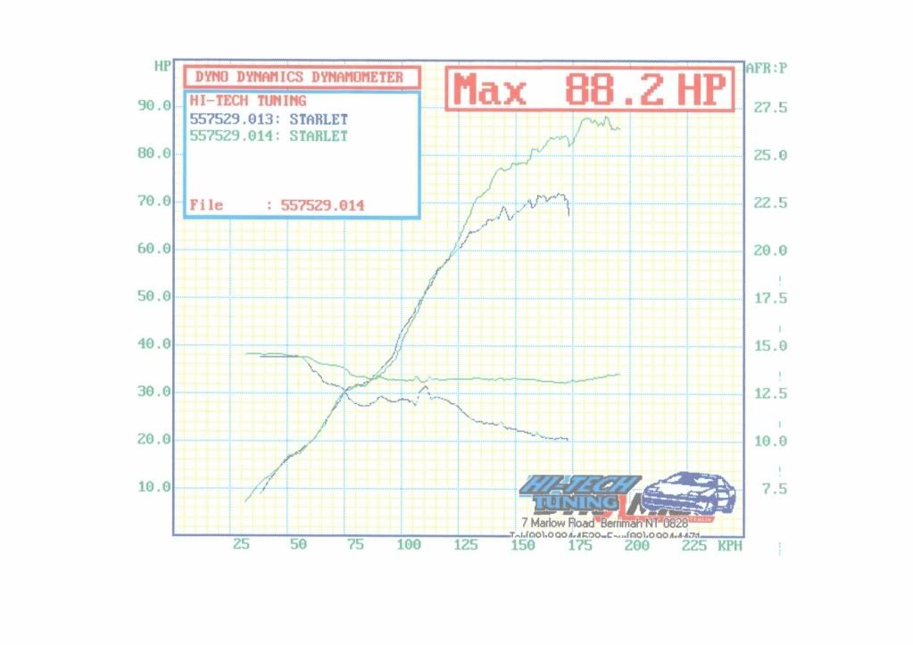

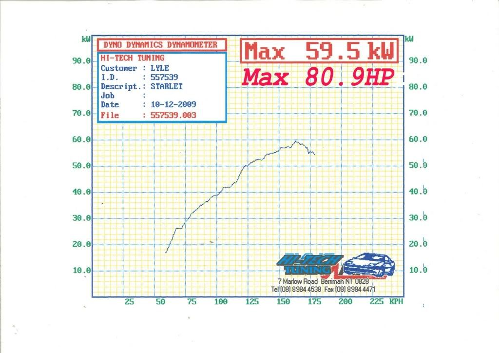

poor tune / result for 1st attempt
slightly better after a bit of fiddling

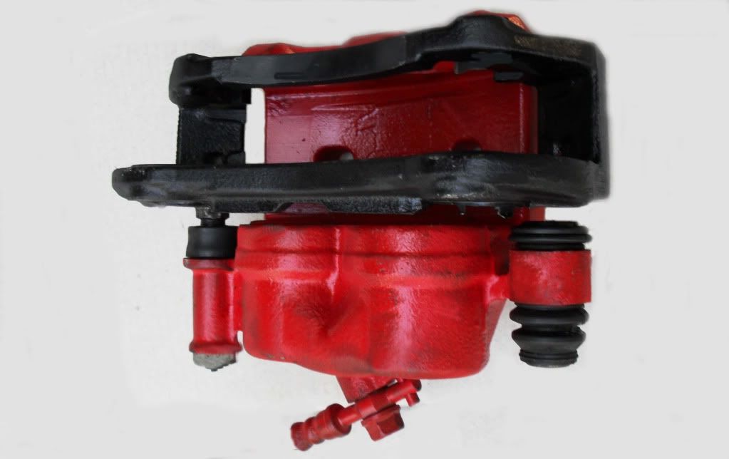

twinpot caliper frt brake up-grade 260mm no spacer
