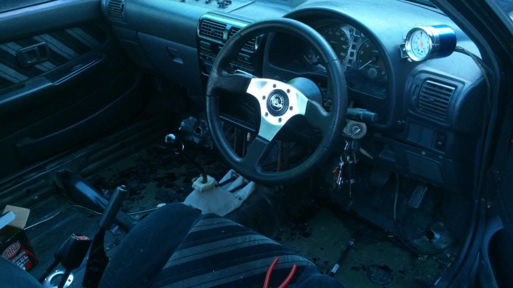

so far I've stripped the interior, begun removing sound deadening, broken something in the driveline (to be continued) replaced cut off shifter assy, fitted TRD gearknob, replaced steering wheel, removed radiator for half size alloy unit, glued up faulty idle valve, sat and drunk beer while looking at vehicle. very productive
pics
after its first clean
interior part way through sound deadening removal and after shifter + wheel fitted

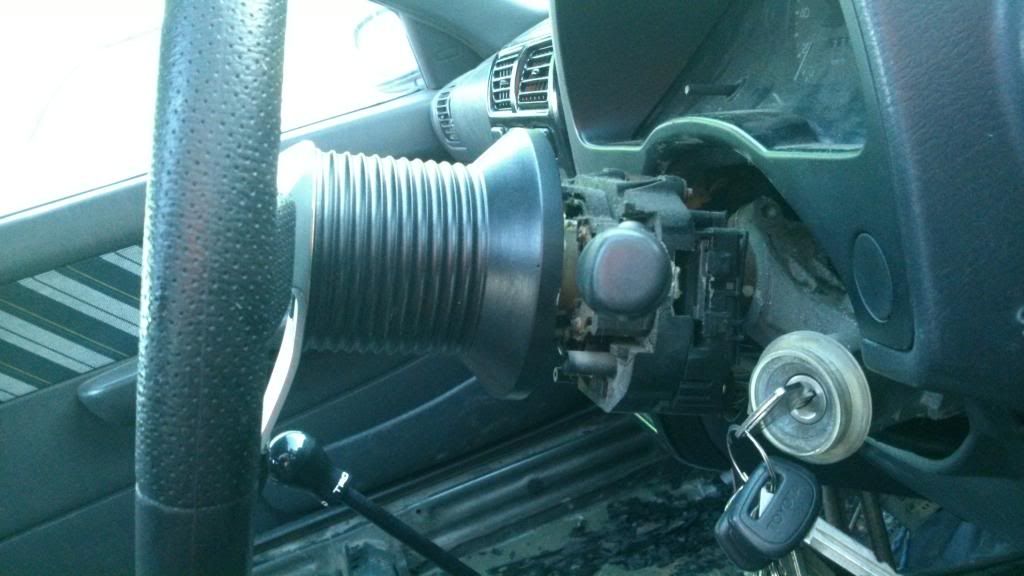

boss kit (turns out its the wrong one and too long/column covers dont fit but it brings the wheel closer to me which will actually work out well, so im keeping it lol

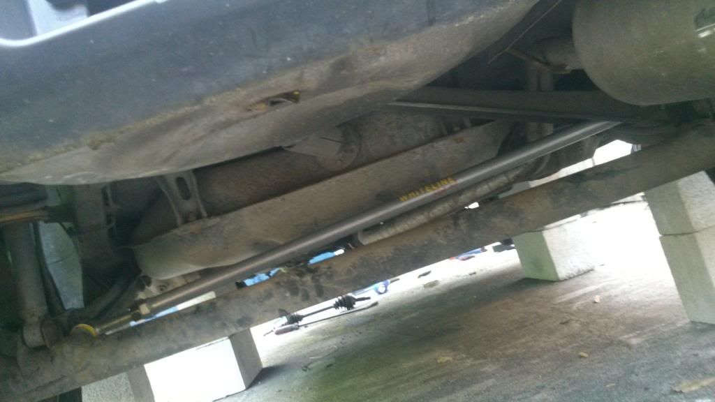

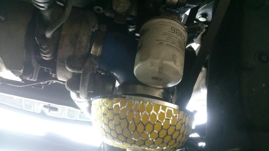

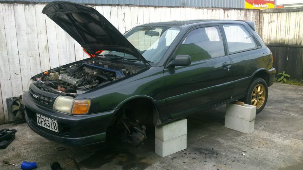

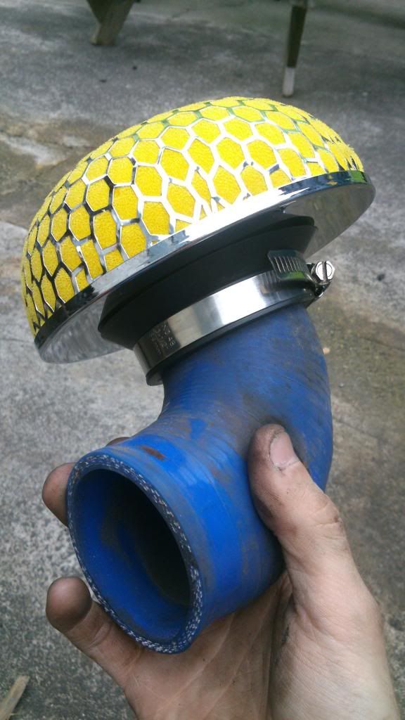

Got a panhard rod off ryan, mounted that and roughly adjusted it. dodgy fitted air filter :lol: put it up on my 1st world axle stands and removed the stuffed driveshaft on the passenger side. will be fitting a new one hopefully tomorrow and will hopefully fit the new brakes I got off steve8 at the same time
tightened onto silicon hose FTW, actually holds well!
my mean axle stands for the moment, looks like im parting the thing out for scrap currently hahaha

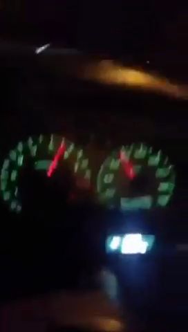

swapped everything to the new starlet, fitted a 10psi spring and going to put it on a wideband to make sure fuellings ok with the current setup :D got new seats! waiting on rails which should hopefully turn up before a trackday im taking it on next month, getting wheel aligned then its good to go! progress this week was slowed due to the subaru developing a severe diff knock on saturday night so i pulled it out, inspected wheelbearings, driveshaft, half shafts, crown wheel and pinion. couldnt find shit, apart from very dirty diff oil. reassembled to recheck the fault and the faults dissapeared! weeeeeird...... took a vid of it on a short power run on the motorway though :D
click on the image to watch, not that impressive but plenty of fun for me :)

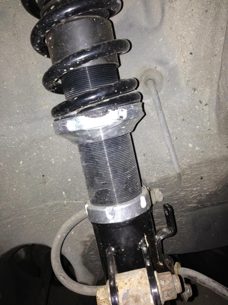

went to an uncles club meet and had a hoon on wednesday, found it has chronic overheating issues (3 laps and its well boiled over), decent guard rub due to the tyres being too wide (not too worried doesnt seem to be wearing them) and found a decent boost leak which once fixed woke it up! keeps up with h22a EG civics now, just got to improve my lines and have more balls in/through the turns! had an awesome afternoon and got some things to improve now so back into the garage it goes. currently running a ep91 dual core radiator but i think the fact the turbo is so close and the screamer points sorta at the bottom tank ish area is probably my cause but will cure it all by fitting a triple core half size and plumbing the gate back in. photos and videos of the suspension rub and the day! took my mate Andrew Waite from the NZV8 utes/ supertourers for a hoon he thought it went great for what it is :P
final run, just starting to get a bit of confidence, skips a section in this vid dunno why, can see steam coming from the overflow on the RHS as i pull into pit lane at the end haha :/
http://www.youtube.com/watch?v=d4b6TCFmLoI
Rub...

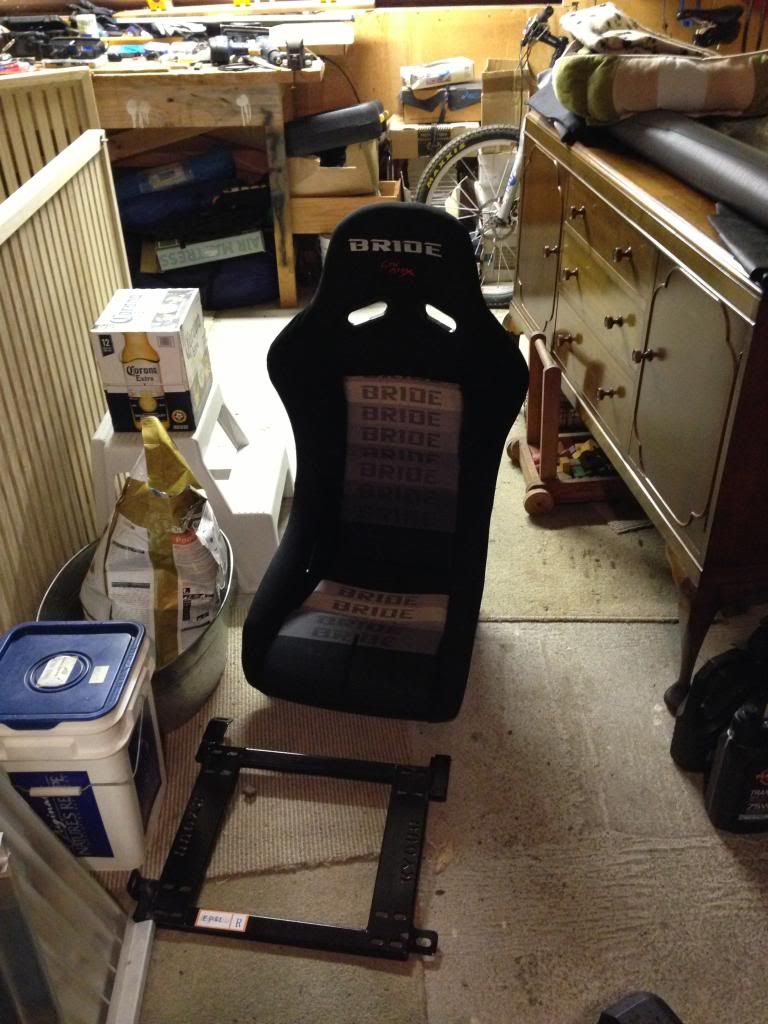

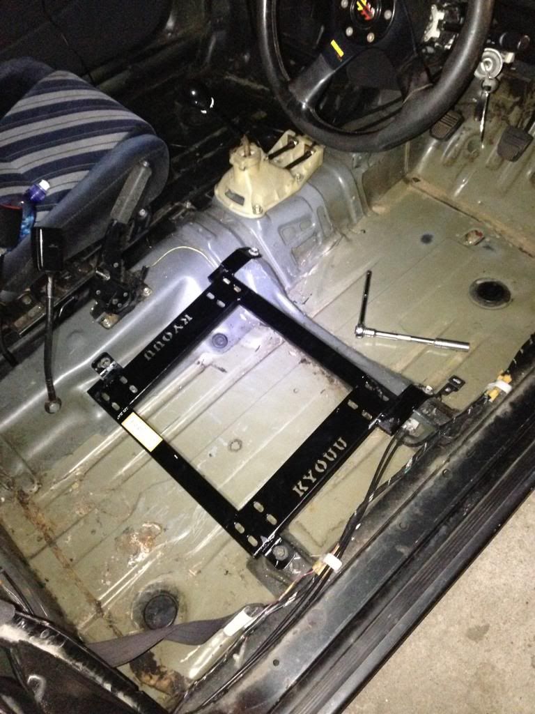

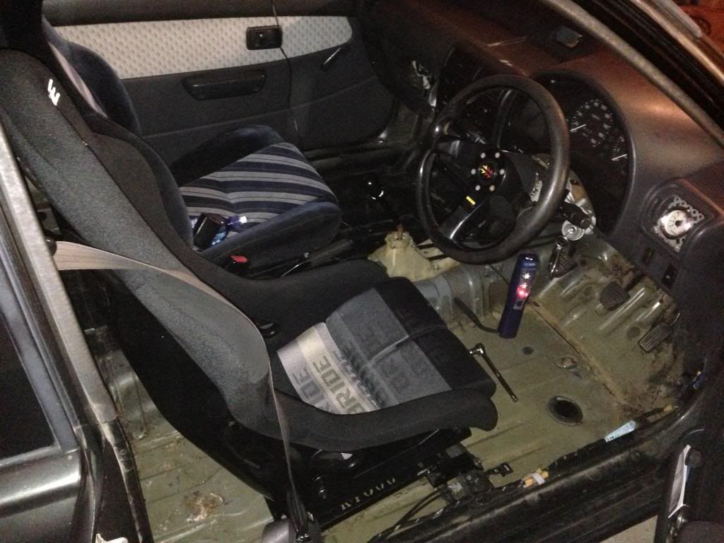

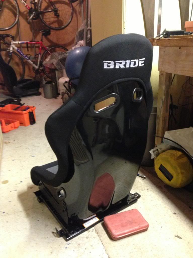

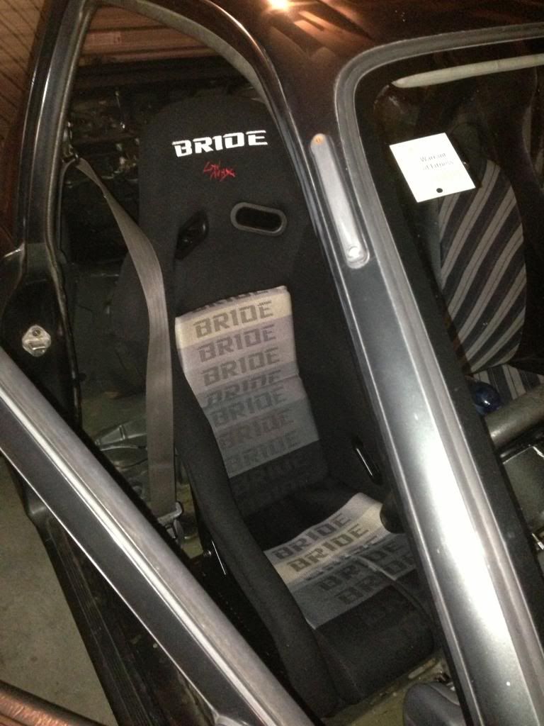

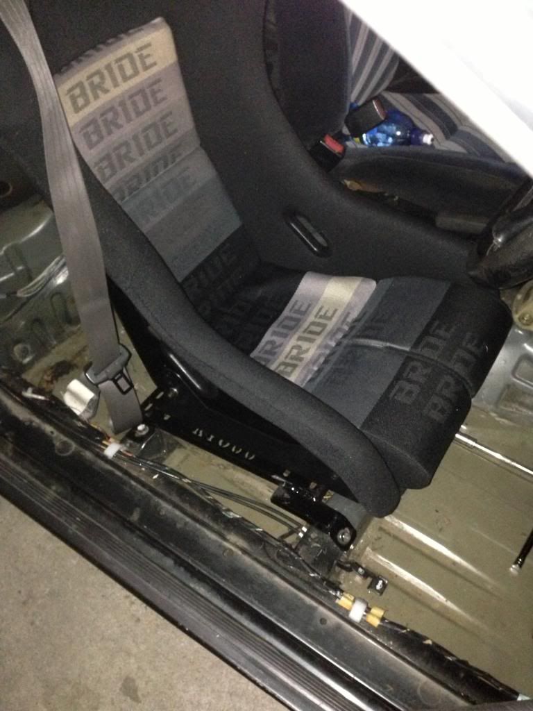

Got a drivers fixed mount to test, mounted seat! happy as with it :)
If anybody needs mounts for their vehicles or some brides hit me up for a price :)

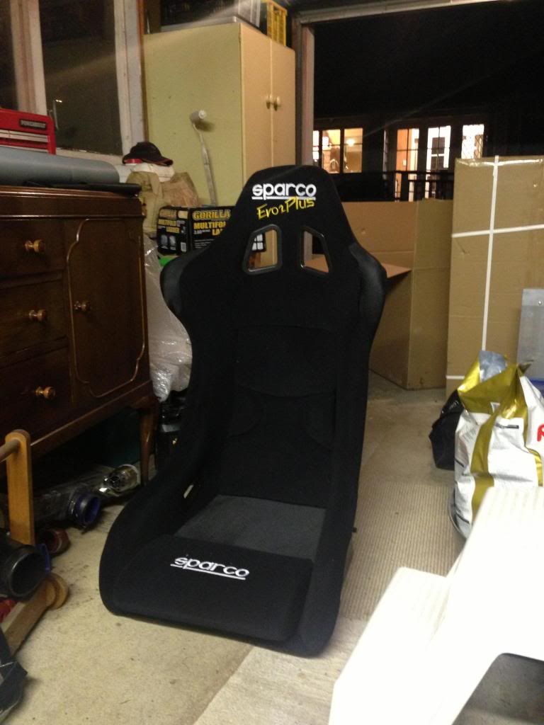

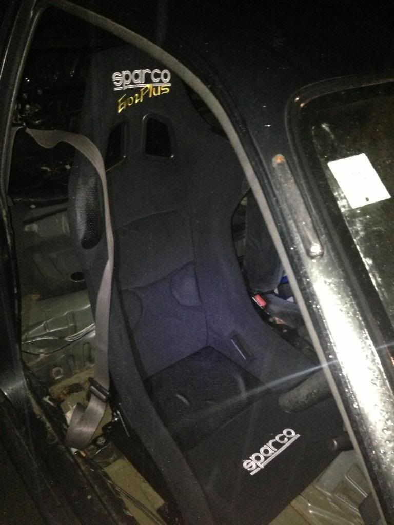

Soo ended up selling my brides as a set of sparcos came up for sale so fitted the sparco! bit roomier seat
need to sort the overheating still and plumb in the gate, then its ecu and injectors!
