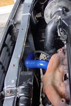

In 2et guise...
2e-telu
C150 gearboxes x heaps (blew quite a few)
VR4 front mount
2 Inch piping
GSR BOV
AES Rallisport Computer
CT9 Highflow
Custom downpine
2.5 inch exhaust
Additional injection via Powerlink ECU and 2x 330cc injectors
Bilstein adjustable platforms
Turbo S front brakes
Best ET 15.2 @ ??km/h - 10psi
I should have pushed this setup more, and really regret it as I didn't run anything more that 14psi in it and it went bloody well. It had alot more potential.
