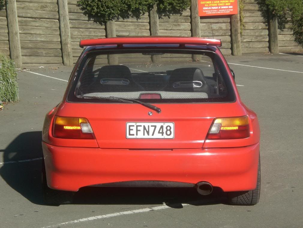

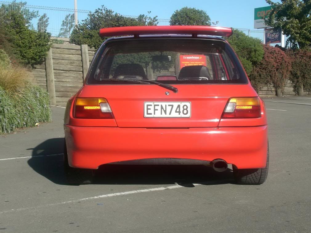

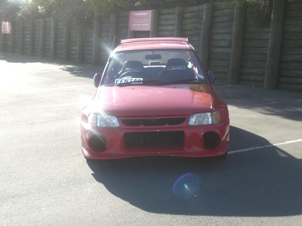

Started life as an 1100 nana spec, im guessing maybe automatic
and yes it has a front mount painted black.

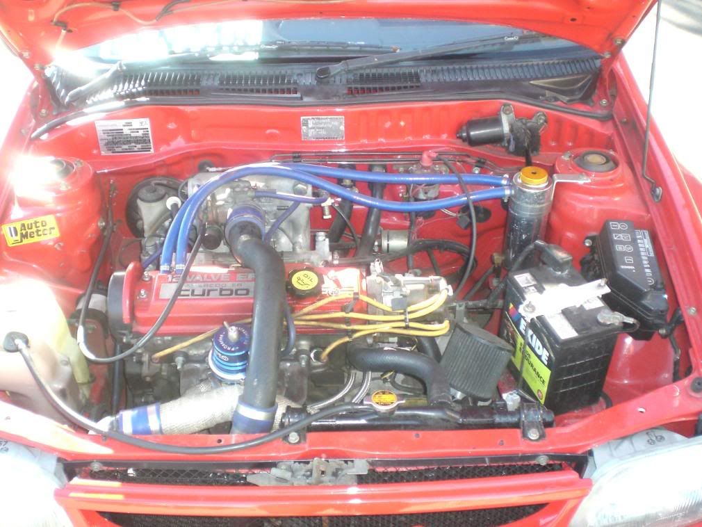

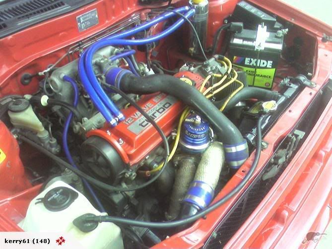

1500cc turbo (Jap spec toyota corolla 12 valve turbo motor?)
custom extractor manifold
bosch in tank fuel pump
evo1 turbo
custom front mount intercooler
wategate & blowoff valve
custom gilmor pullys & belt
link plus ecu
2.5 inch exhaust & stainless rear muffler
Corolla 5 speed LSD G/B
Brass button clutch

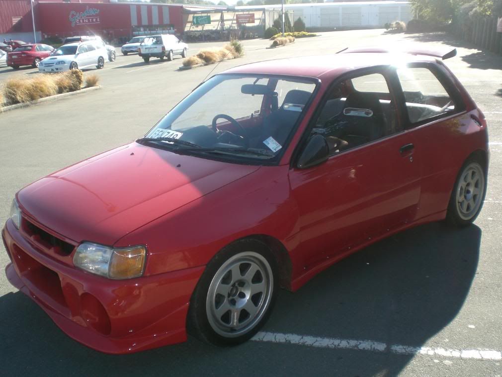

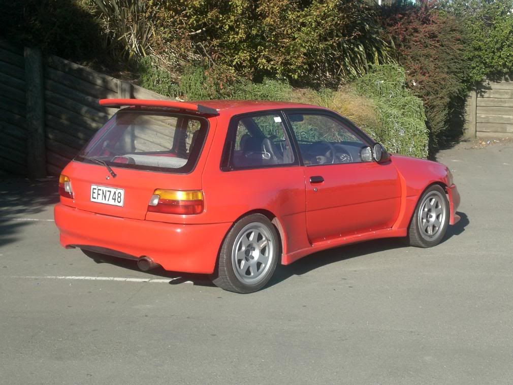

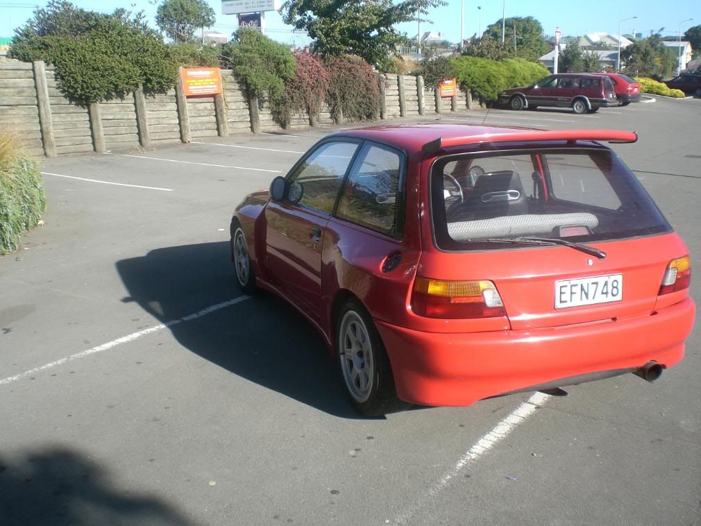

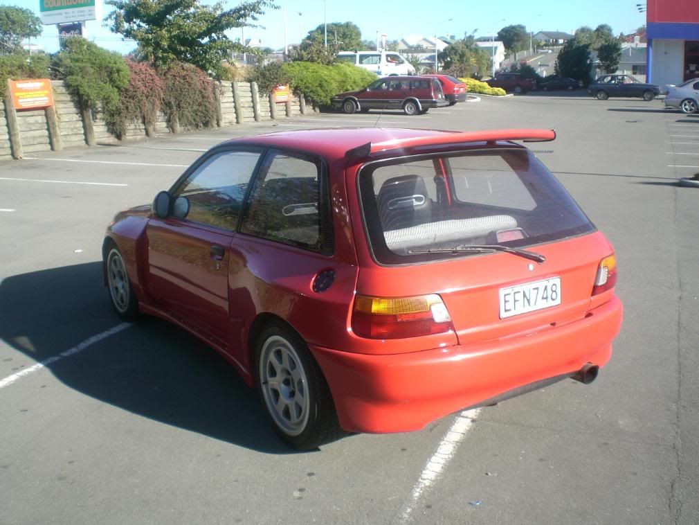

custom wide bode kit around 3" wider on each side
custom fr & rear bumpers & side skirts & rear spoiler
CArbon fibre wing mirrors
Subaru 5 Stud hubs
widened wheel track
modified strut towers, raised 30mm, to counter negative camber
willwood 4 pot calipers fr & rear
willwood drilled rotors fr & r with removable alloy centres
willwood brake bias control
hydralic hand brake with seperate calipers
16" speedline light weight wheels
225/40/16 yokohama tyres
momo seats & steering wheel
boost gauge & monster tach
im sure there is much more i dont no about yet.
Was featured in fast fours in december in 2002, was built by carbon composite guru who was then working for possum bourne motorsport.
The widebody kit took 3000 hours to perfect, or 125 days straight, and the moulds took 34 four letre tins of bog to design. (which i bought with the car
All the gaurds are tube reinforced for strength and weigh less than the originals.
Power was estimated at 125KW before the Evo turbo, manifold and wastegate were installed, on a run in tune. i guess ill c what it can make when it arrives in a day or two, but im expecting good things?
ill get better picks up when i get it.
Let me no what you think,
