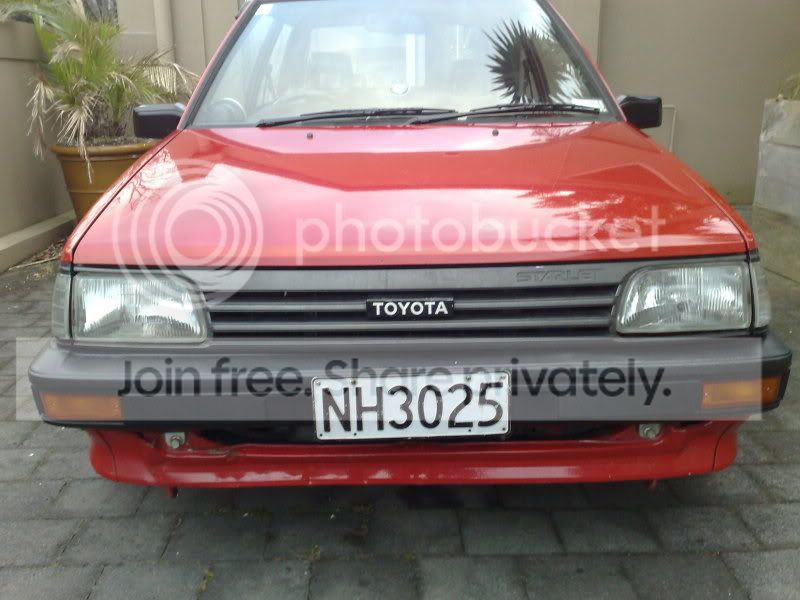

Post by Alistair » Thu Mar 12, 2009 7:07 am
MODEL : Toyota Starlet EP70
YEAR : 1987
ENGINE : Glanza V 4efte
Mods as below
4EFTE ('98 Glanza V engine done about 70km)
TDO4L Turbo (WRX)
GFB manual boost controller
Custom Quikstarly Exhaust Manifold (Wrapped)
Custom Quikstarly Short Shifter
Modified GTI-R FMIC
Custom Alloy I/C Plumbing
Genuine HKS SSQ Blowoff valve
SARD Rising Rate Fuel Pressure Regulator w/ gauge
Pod off Turbo
Custom Downpipe
Twin-core Civic Radiator w/ aftermarket fan (switch on dash)
KYB shocks with Dobi springs (front)
GAB damper adjustable shocks, not sure of the springs (rear)
EP82 GT front hubs/brakes
15" Enkei RP02 Alloys
Starlet Si Fuel tank and lines
MR2 GT Fuel pump
Alloy Catch Can
Starlet Turbo-S Strut Brace
Starlet Si Front seats
Nardi steering wheel
Solid engine mounts
Tacho / Boost / Water Temp / Volt gauges

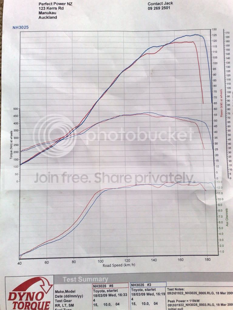

Boost gauge is out slightly, so it was only running 13psi, made 126kw atw on 13psi with stock injectors around 80% duty.
Not as much as I'd thought but still damn good power for daily 700ish kg!
Will try and track down some 7mgte injectors and go back to dyno in a few months for 15-17psi to run for trackdays/drags/lols.

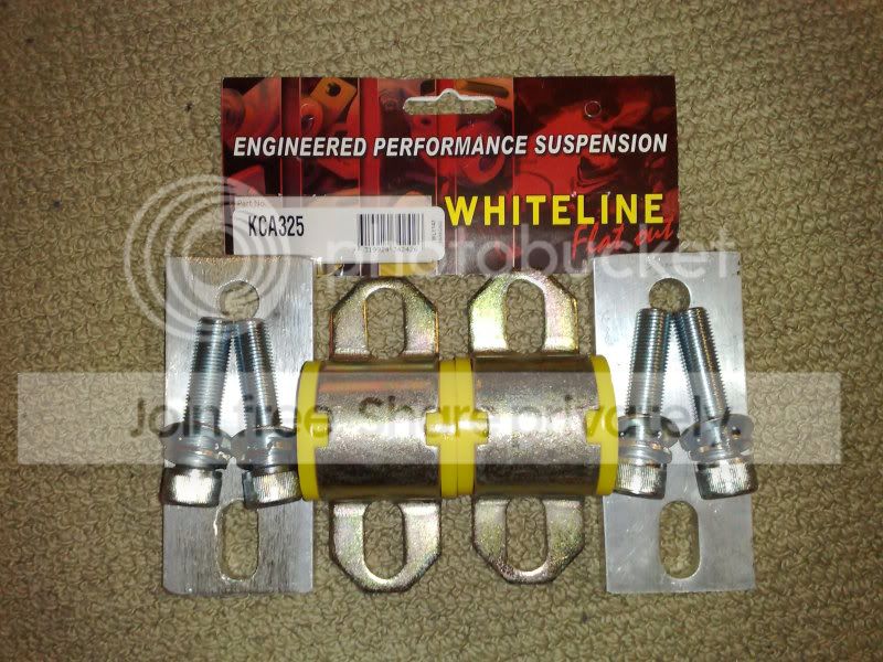

Whiteline antilift kit to be installed when i get round to it.

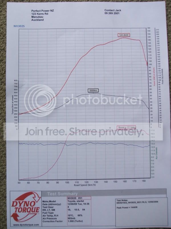

And my 144kw dyno run.
