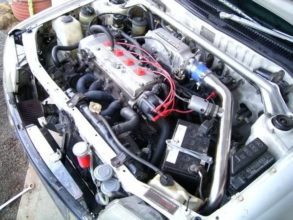

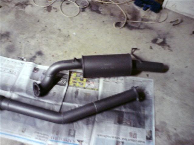

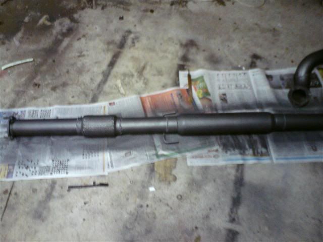

I bought the car about 8 years ago, pretty much stock except for a 2.5" press bent exhaust and a ct12 from a hiace. Drove it around for a year untouched until I started talking to Kris who pretty much made me start changing stuff. Fiddled around with a few minor things in it like Trd leads, Rx7 top mount, Mr2 fuel pump and some random BOV.

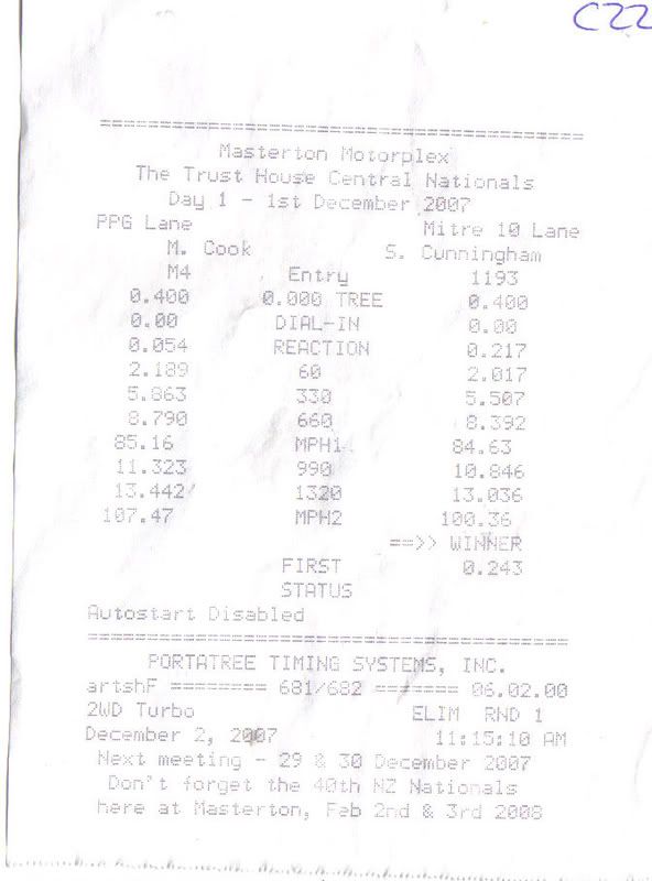

Went up to the 2nd? Honda vs Toyota drags like this, track was horrible and I broke a selector cable and ended up with an epic 16.1@146km. Drove it home from Meremere to Masterton not being able to select 5th or reverse. Found a pic someone had took from the day too.

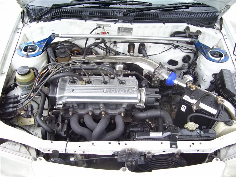

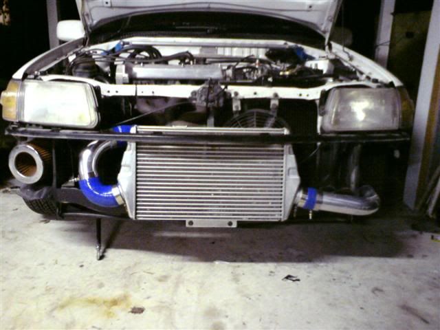

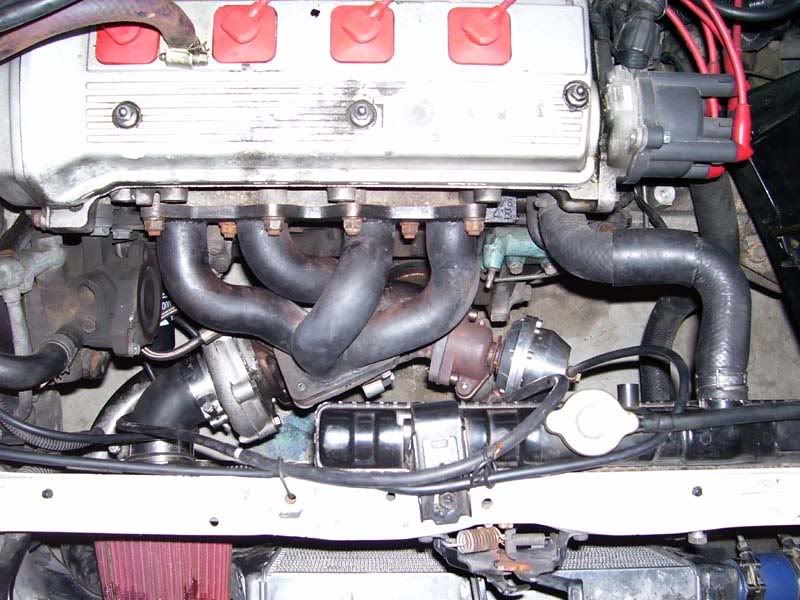

Not long after this I succumbed to Kris telling me how much standard turbos sucked, he had a few bits lying around and had upgraded his v4 link to a link plus so I decided to drive all the way up to his house and get some Teal Bay modifications.

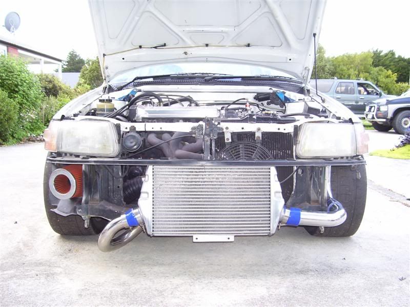

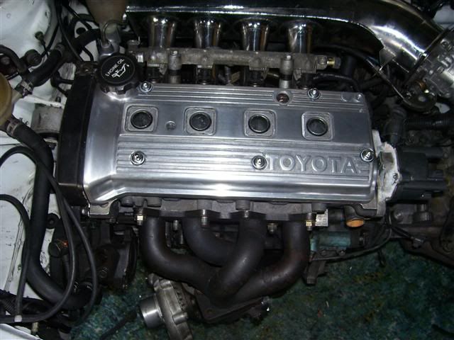

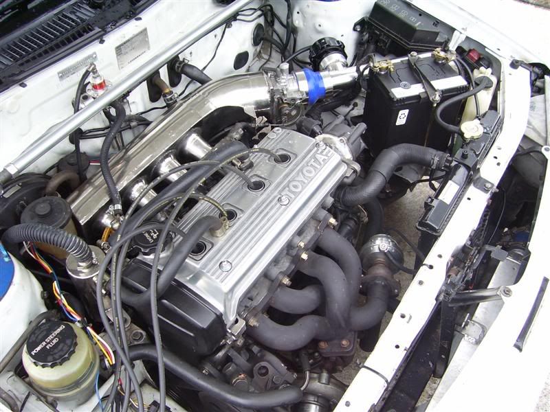

Ended up with the following setup:

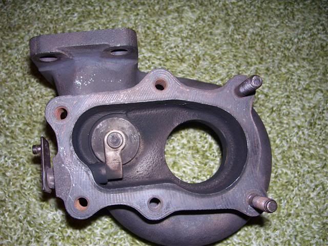

T3 off a LD20
Custom exhaust Manifold
2.5" Drop pipe
ACIS Mani
Vr4 Intercooler with 2" Stainless piping
V4 Link

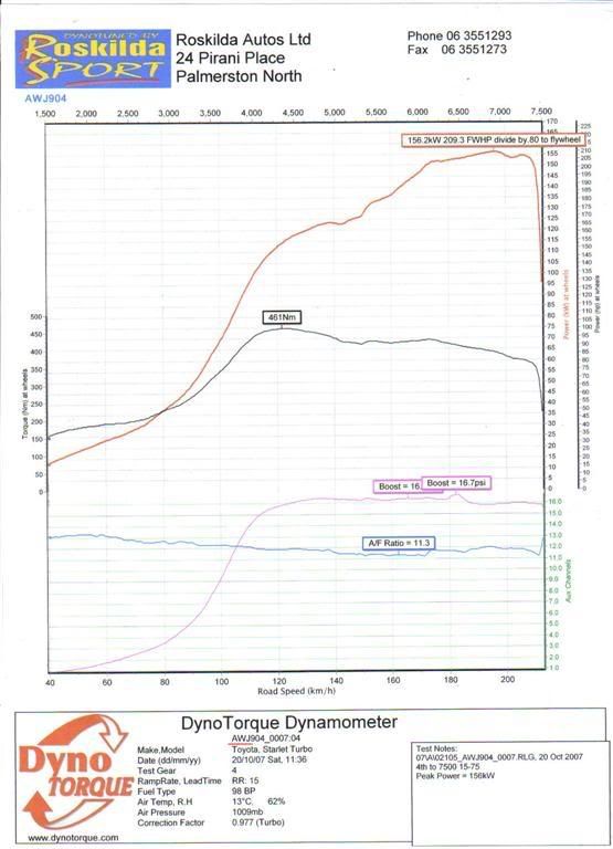

Was running wastegate boost which was around 8-9 psi, was a major improvement over the old setup. Had this dyno'd at a toyspeed dyno day and it made 101kw, then the tuner made some tweaks to the tune and it ended up at 114kw.

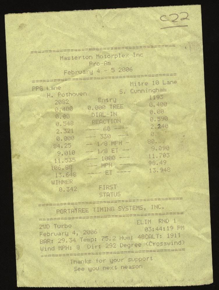

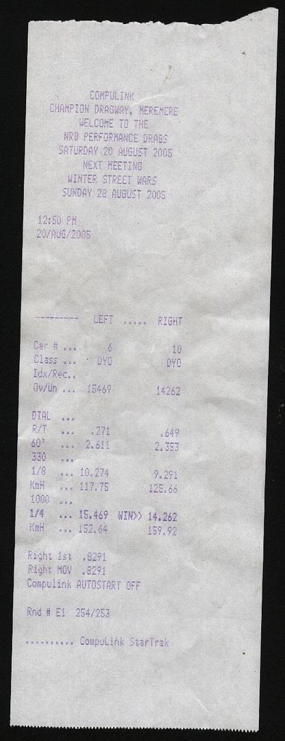

Took it up to a private drag day at meremere and was quite suprised to get a 14.2@160km.
