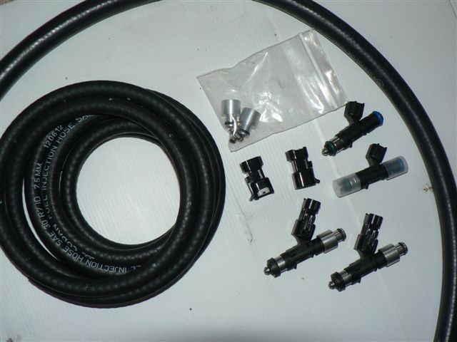

The adapters for the ID1000 injectors have arrived , you can see them fitted to the bottom two injectors in the pic, at only $16US for 4 it makes for an easy upgrade with no rewiring to do. :tup: 8)
The only issue so far is the injectors with their adapters on are 12mm longer than the denso ones I'm taking out , so will have to make some new spacers for the fuel rail.

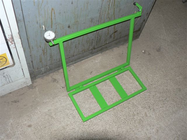

I have decided to sort the handling out as the next project , I am starting with bump steer so I made this gauge , I just have to make the wheel board then I can see how much I have . Judging by how it goes all over the place on road camber and more so when shocks are on soft setting I'm thinking a fair bit.
I told my powder coat guy to surprise me , I quite like the Kermit green , pretty sure there's not another one like it :lol:
After I measure the bump steer I think I will need to fit rod ends to the steering rack arms and mount them under the steering arms on the hub and shim them .
Then there's the roll center adjusters I want to make and maybe caster plates to fit to the coil over camber plates
